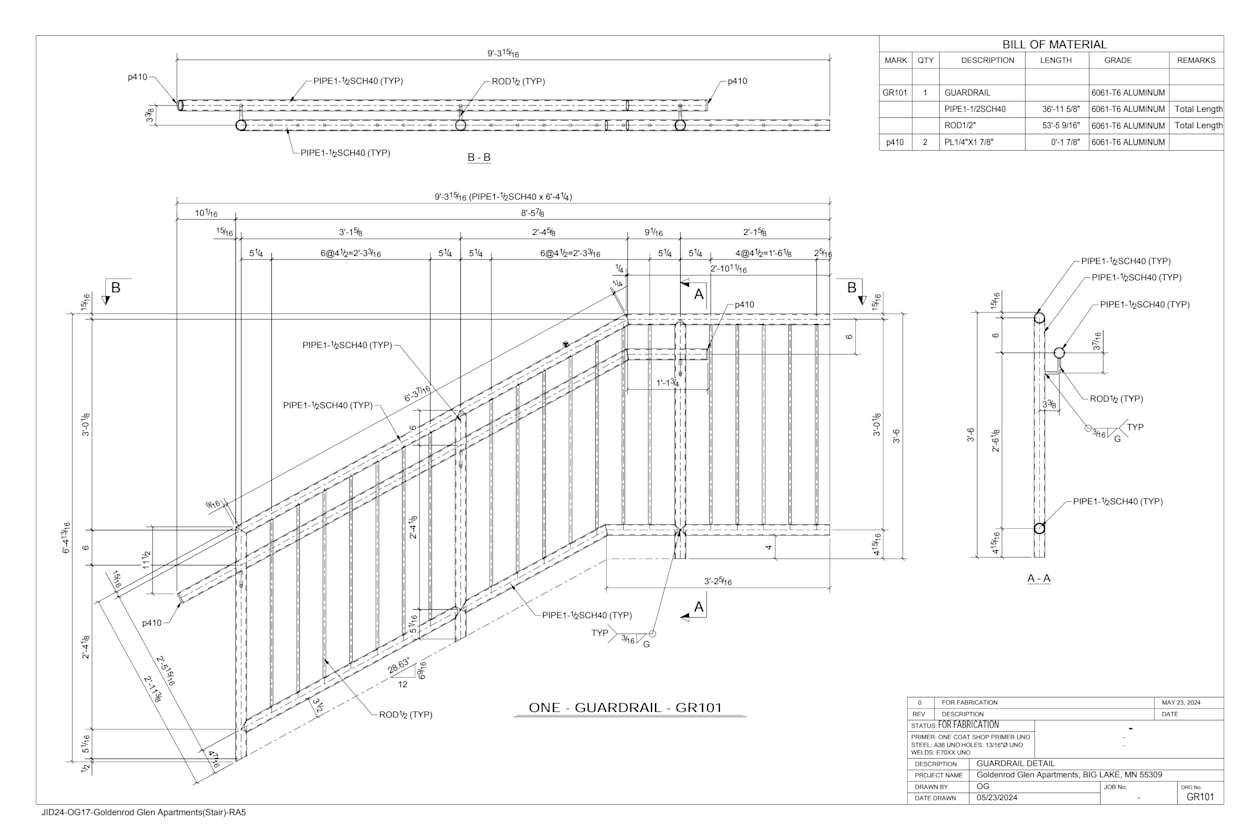

In the first photo notice the guardrails and all the 1.5" box tubing parts. Normally there are 3/4" pickets instead of the mesh panels.
Then there are all the pieces of pipe for a handrail project.
The last image is an example I found of an assembly drawing for a guardrail. Normally these assembly drawings have a list on the top right listing every part's dimension and type. There is a further parts drawing list that has all the material in a packet.

Imagine hundreds of parts drawings such as the one below.

Here's a better example of an "assembly"

You may want to look at JD2 (JD Squared) rotary tubing cutters. (XR6 & XR12)
I seem to recall a video where Bob Hughes (owner) talks about their proprietary software translating Tekla files really well.

The JD2 XR12 looks interesting. This machine would help us process the stringers, whether they are c12 or 10x2 box tubing. I have spent a few hours watching videos on the JD2 cutters and it accepts .stp files that we can get from our detailers.
I have also noticed the Bend Tech Dragon A400. Not sure what is better, a fixed cutting point or a moving gantry.
Either of these machines would help with all the pipe and tubing we have to process for handrails and eliminate a dedicated coping machine.
If it's a guardrail made out of 1.5" bt then I believe either machine will process all the unique cuts quickly and we can bundle all the pickets on the bandsaw like we normally do.
There are laser machines out there for $40K-50K but I have not been able to learn anything than general specifics.
