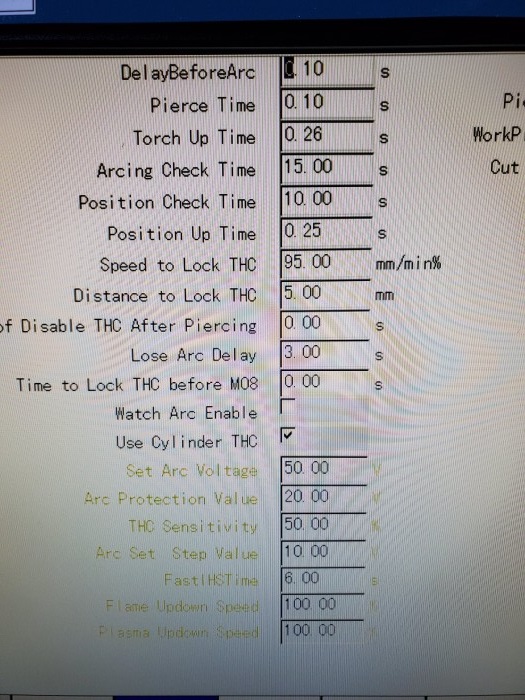

Thanks for the feedback. I've taken a screenshot of the set up I'm using to cut some 16 gauge hot roll. I've played with just about every setting in this menu incrementally and I cannot seem to get The torch hide controller to respond to anything. Please have a look at my settings menu and tell me what you see that is completely off base.

Re: Hi All!
Your software is not one I have used so not help sorry.
But I would say the THC sensitivity is way to high you need from .5 to 1.0 volts and set arc voltage should be set for the TD unit you have

Re: Hi All!
So just an update... with all of the subtle changes I made to the cut profile option menu, I was able to cut 1/4" mild steel plate which I believe is a very acceptable cut. However, up to this point I still have no control or movement of the torch in the x axis. Also the Voltage feedback isn't registering on the screen either...The 16 gauge steel cut pretty good, but as the sheet warps, the Torch won't compensate, or sense the base metal height change, thus collides, and stalls...Either there's a hidden check box disabling this feature that I can't find, or a software glitch, or a setting on this menu that is beyond my understanding, or description in the so called manual. I am bewildered as the why a company would sell a piece of equipment with crap for an explanatory manual. A couple of simple cut profiles for maybe three thicknesses of common steel materials would be a Golden Ticket and probably a lifesaver for the amount of Tech Support calls I can imagine they recieve... and the patient wait for tech support call back goes on.

Re: Hi All!
Ok I cannot comment on their software but with most there is a input signal that tell the controller arc OK (on) and to move the torch up and torch down, and an enable for the THC so the software knows to look for these signals. These signal require a connection to the Plasma unit, this may be the reason you are not seeing the arc voltage. I agree there seems to be some really poor companies doing business, this is why many newbies ask about the tables they are looking at or who to avoid.

Hi Jester,
We're up and running...After a voltage test with the tech support, they said the voltage divider was faulty, so they sent me a new one....
we wired it up and had nothing change, so we ended up chasing down a reversed wire polarity in the factory harness.
And now we have correct reading voltage and a torch that reacts to the elevation changes in the surface material.
