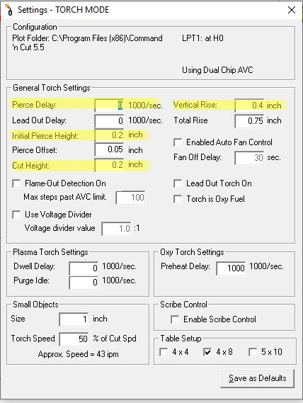

  1. Click on Edit>Settings to open the settings window shown below
  2. Enter the settings highlighted in yellow shown below when using the EasyScriber
