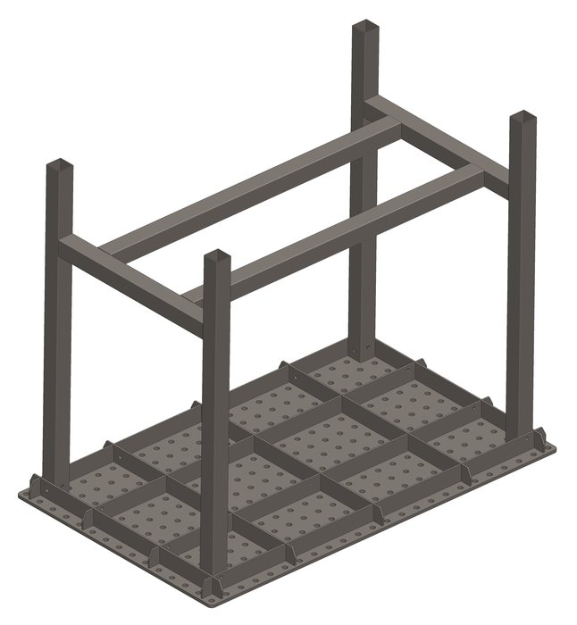

here is one version I have drawn. I laser cut and carefully welded to reduce excessive heat. Because of the puzzle tabs, the table assembled very flat and stable. I will upload the accessories when I get a chance.
fixture top 29-5X47-5 375 ms 1 pce.dxf
fixture rib short 29-5X47-5 187 ms 5 pcs.dxf
fixture rib long 29-5X47-5 187 ms 4 pcs.dxf

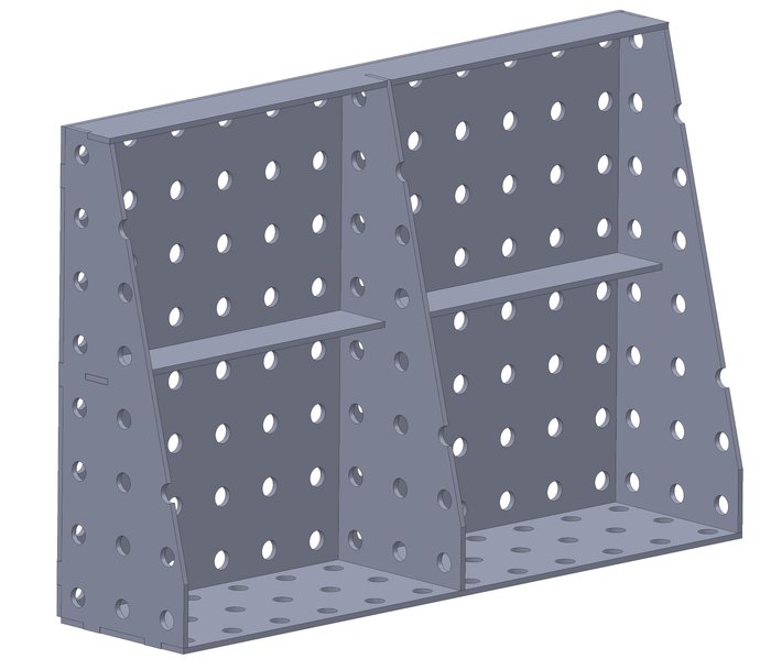

Here is the large accessory piece. As with the table, all the parts are cut with 3/16" mild steel. I allowed .003" clearance around all puzzle tables. 5/8" holes for standard table clamps.
fixture square side plate 187 ms 2 pcs.dxf
fixture square top plate 187 ms 2 pcs.dxf
fixture square front plate 187 ms 1 pce.dxf
fixture square middle plate 187 ms 1 pce.dxf
fixture square bottom plate 187 ms 1 pce.dxf

here is a pic of the underside of the table

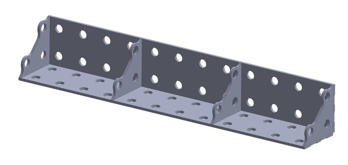

small angle fixture
fixture angle gusset 187 ms 4 pcs.DXF
fixture angle long 187 ms 2 pcs.DXF
