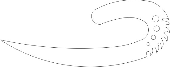

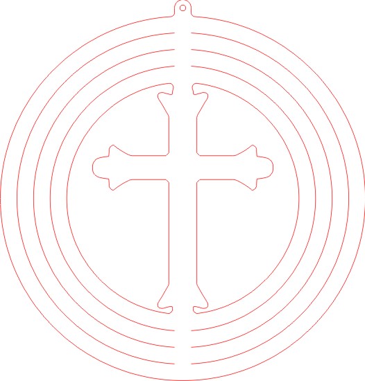

Here you go guys and gals, enjoy :D
The saber once sharpenned works real well on skinning moose and deer. We use them every hunting season my party and I.

Thanks Joe!! Thats a cool knife.What kind of metal do you cut it from?Again thanks for the many files you share I have extreme trouble with computers especialy drawing programs and you help alot I am getting better will share whatever i end up creating . :)

What version of AUTOCAD do you use. Every file I try to open I get an error message and it does not come over. I use AC2004 on my laptop but I have 2008 just no internet on that computer due to the age of the PC I can't run anything but AC08 on it. If you can tell me how to open them I will beg my daughter to name her first child "Plasma Joe" :lol: You seem to have some neat stuff on here I just can't get to it. Thanks in advance.

Hmmm... that a fine offer naming your daughters first child Plasma Joe, but I strongly suggest you don't LOL, one Plasma Joe is enough just ask my wife LOL. I use AutoCad Mechanical DX 2004 and some files are done in AutoCad 2010 LT. To open the files as a DXF save to a folder, open a blank drawing and turn off all layers, I draw with no layers, for art work, but when I design machinery and building or the sort I so use layers. Hope this helps you Erichsmith.
As for you Dustan, I use AR 375 or AR 500 3/16" plate. I am glad to help you out, I really don't know the scan and drawing softwares that much, I do my drawing the "old way", freehand, love doing it that way give me great pleasure when it is finshed. It does take much longer to do but I like it that way. Been dong it for over 20 years now why change a good thing eh? Take care and I am looking forward to see what you will create.

Still no dice. This is the response I keep getting.
"Unknown value "AC1021" encountered in drawing version.
Invalid or incomplete DXF input -- drawing discarded."
I'll do some research but if there is any insight someone feel free to share. How about Plasma Jane if it's a girl.... :lol:

LOL!! Good one. I did some reasearch on the file and it is done with Cad 2010 I will get it save in an old version for you, but you will have to wait till my holidays are over on Tuesday.

Maybe I can help out. Here are the files in ACad 14, both of your computers should be able to read them.
