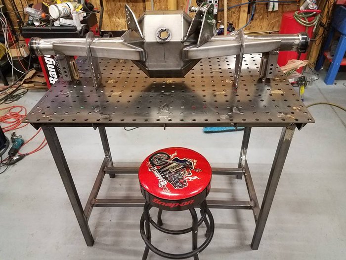

As drawn? What material thickness? How is fitment?badassr1 wrote:cut great for me!
- Posts: 52
- Joined: Thu Apr 07, 2016 6:16 pm
Re: 4x4 welding table help
used 3/16 like he stated in his posts. and yes as draw. used correct offsets and bam..

yaa.. it does not take a full sheet an i put three clamps an i missed the flat clamps going to add them in .badassr1 wrote:anyone lay this out to cut on one sheet of 4x8?
- Posts: 373
- Joined: Thu May 28, 2015 8:02 am
- Location: Merritt island fl.
just in case some wanted this all nested i set it up for my water jet .080 clearance an there are 3 clamps of the one an 3 of the other in this post

Ya I figured that out when I cut it.. Took under half a sheetradicalrescue wrote:yaa.. it does not take a full sheet an i put three clamps an i missed the flat clamps going to add them in .badassr1 wrote:anyone lay this out to cut on one sheet of 4x8?

I haven't had time to play with the test tabs yet. Those of you who plasma cut these from 3/16", did you have to adjust the clearances at all? With 3 degrees of taper, on 3/16" it looks like about .010 of clearance would need to be added.

I added closer to .015 and lots of the Dogbonesmotoguy wrote:I haven't had time to play with the test tabs yet. Those of you who plasma cut these from 3/16", did you have to adjust the clearances at all? With 3 degrees of taper, on 3/16" it looks like about .010 of clearance would need to be added.

I cut the toggle clamp and the push clamp with a laser and they turned out great. I did have to open the holes up .005 on the toggle clamp to fit the 3/8 bolts in. but they are great files, thanks again hemichargersrt8!

I am looking forward to cutting this. I have plasma cam 311. I cut some test pieces an the tabs inserts were to small. I think it might be because I was clicking on the inside when converting to cut path. if i click outside the i have the lead in cut. any help on what settings should be. thanks for any help. I am new to this just got table a month ago. thanks so much to Hemi. what a grate file he has shared.
- Posts: 228
- Joined: Sun Dec 09, 2012 6:31 am
Hello Vanquish, maybe try and cut this sample piece. If possible, use the same thickness of material that you want the finished part to be made of. After cutting, measure the cut part as accurately as possible (digital caliper). The outside profile should measure 4 inches x 4 inches. The inside profile should measure 2 inches x 2 inches. To check to see if the table axis are square, the part should measure 5.657 inches from corner to corner. If the sample part is different, you will need to adjust cutter kerf compensation in your software.
